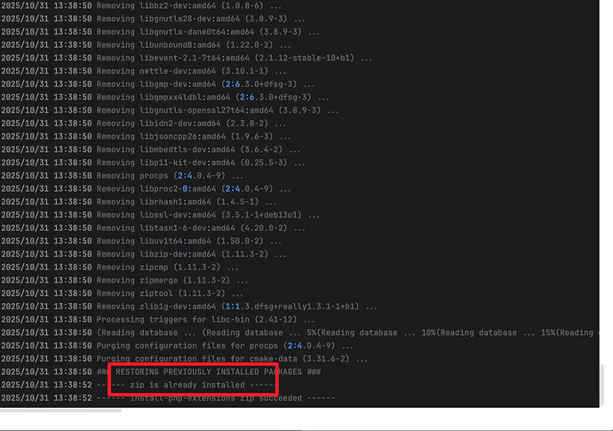

------ install extension: zip ------
install-php-extensions v.2.9.8
Updating channel “pecl.php.net ”
Channel “pecl.php.net ” is up to date
Hit:1 Index of /debian/ trixie InRelease
Hit:2 Index of /debian/ trixie-updates InRelease
Hit:3 Index of /debian-security/ trixie-security InRelease
Get:4 Index of /debian/13/prod/ trixie InRelease [3952 B]
Err:4 Index of /debian/13/prod/ trixie InRelease
Sub-process /usr/bin/sqv returned an error code (1), error message is: Missing key EE4D7792F748182B, which is needed to verify signature.
Reading package lists…
W: OpenPGP signature verification failed: Index of /debian/13/prod/ trixie InRelease: Sub-process /usr/bin/sqv returned an error code (1), error message is: Missing key EE4D7792F748182B, which is needed to verify signature.
E: The repository ‘Index of /debian/13/prod/ trixie InRelease’ is not signed.
------ install-php-extensions zip failed ------

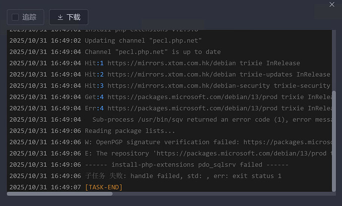

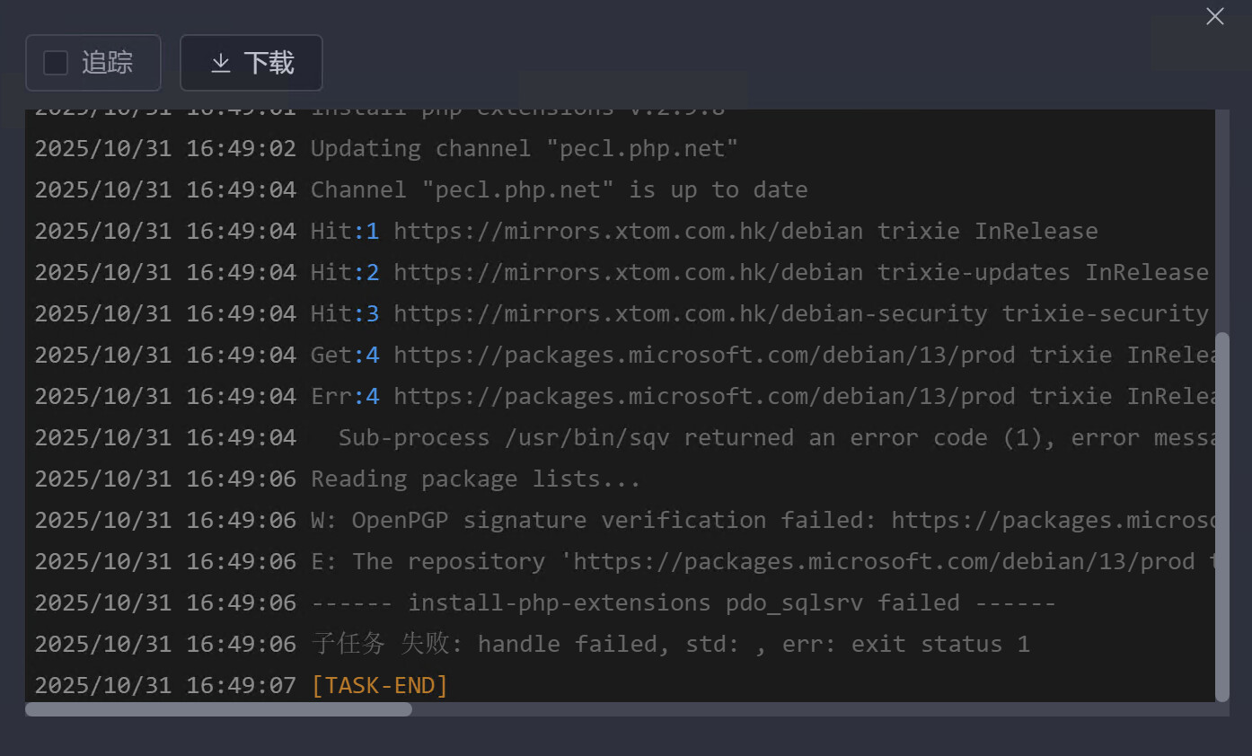

试了香港的服务器也是这个报错,刚测试的:
2025/10/31 16:41:50 Get:1 Index of /debian/13/prod/ trixie InRelease [3952 B]
2025/10/31 16:41:50 Err:1 Index of /debian/13/prod/ trixie InRelease
2025/10/31 16:41:50 Sub-process /usr/bin/sqv returned an error code (1), error message is: Missing key EE4D7792F748182B, which is needed to verify signature.
2025/10/31 16:41:50 Hit:2 Index of /debian/ trixie InRelease
2025/10/31 16:41:50 Hit:3 Index of /debian/ trixie-updates InRelease
2025/10/31 16:41:50 Hit:4 https://mirrors.ustc.edu.cn/debian-security trixie-security InRelease
2025/10/31 16:41:53 Reading package lists…
2025/10/31 16:41:53 W: OpenPGP signature verification failed: Index of /debian/13/prod/ trixie InRelease: Sub-process /usr/bin/sqv returned an error code (1), error message is: Missing key EE4D7792F748182B, which is needed to verify signature.
2025/10/31 16:41:53 E: The repository ‘Index of /debian/13/prod/ trixie InRelease’ is not signed.
2025/10/31 16:41:53 ------ install-php-extensions pdo_sqlsrv failed ------
2025/10/31 16:41:53 子任务 失败: handle failed, std: , err: exit status 1
2025/10/31 16:41:54 [TASK-END]

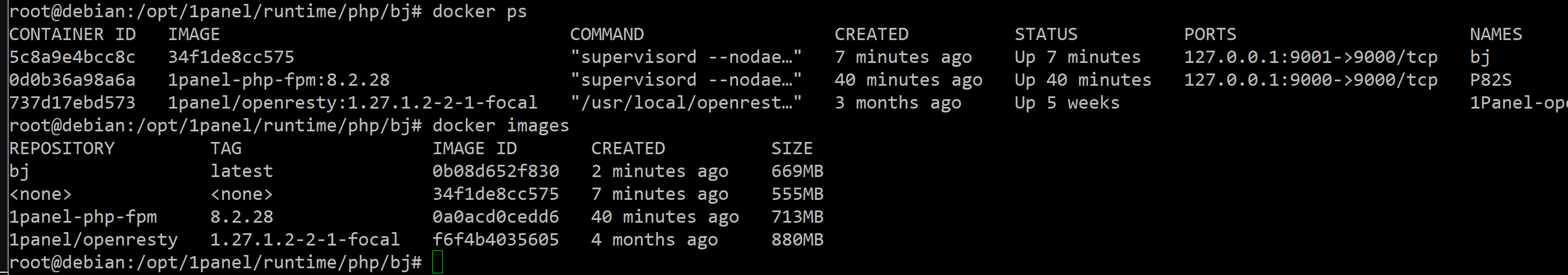

应该是由于基础镜像改为了 Debain 13 但是微软还没有发布 pod_sqlsrv 需要的系统库 所以现在暂时无法安装

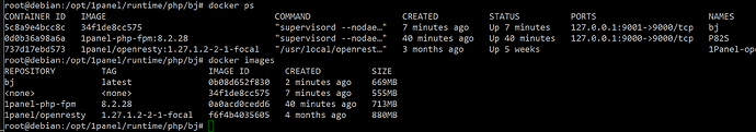

你可以先使用旧版本试试
在你创建的 /opt/1panel/runtime/php/<php_name>运行环境目录下
找到 .env 文件 修改 PHP_VERSION 这个参数 为 8.2.28
然后执行 docker compose build
感谢提供支持 。

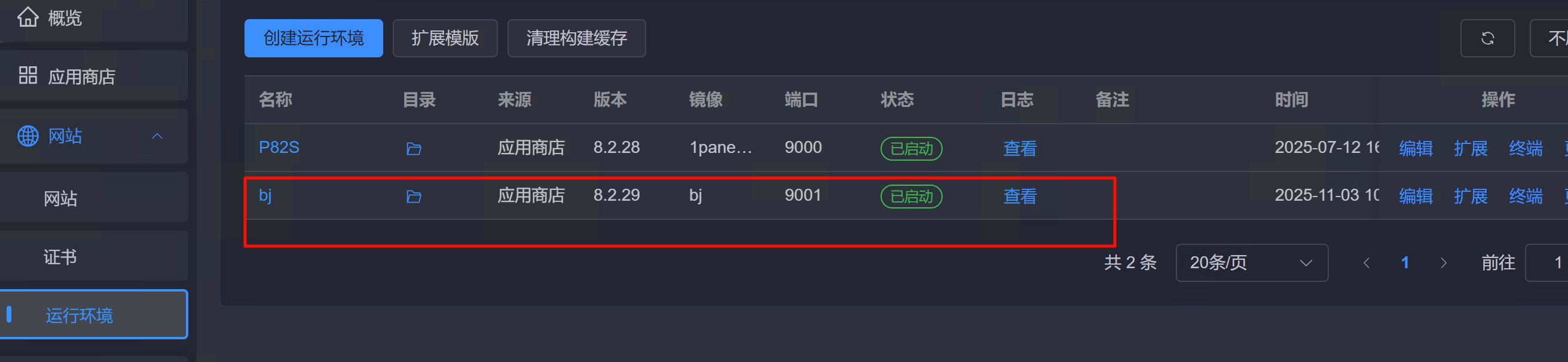

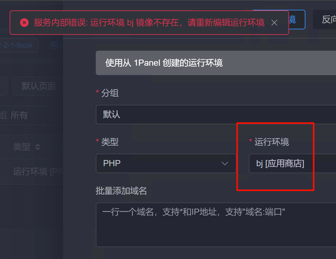

但是,按照步骤操作后,无法新建网站;之前选择这个镜像的,也无法改成其他的。
报错内容为:
服务内部错误: 运行环境 bj 镜像不存在,请重新编辑运行环境。
注:bj为创建镜像的名字。
然后我把env文件改回去,重新编译,也还是不行。在运行环境,点编辑,再点确认,重新编译后,也网站选择这个镜像还是同样的报错。
你给的方式,我几个服务器都试了都不行呀。很容易复现的,你试一下就可以验证的。
镜像名称需要 1panel-php-fpm:8.4.13 类似这种 单独 bj 不带版本不行
大佬 我是按照你写的步骤来的:
这个步骤应该怎么改吗?麻烦告知一下,折腾了好几天了,谢谢
删掉这个 创建一个 PHP 运行环境 镜像名称使用 1panel-php-fpm:8.2.28 或者其他的也行 保持 《《名称:版本》》 这种格式
