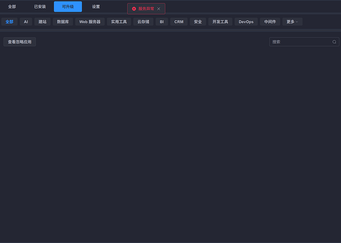

1Panel 在访问应用商店时出现“服务异常”错误
1Panel 版本:v2.0.13
操作系统(设备): ubuntu-22.04 aarch64
日志:2025/11/25 03:31:39 [Recovery] 2025/11/25 - 03:31:39 panic recovered:
interface conversion: interface {} is nil, not map[string]interface {}
runtime/iface.go:275 (0x24467)
github.com/1Panel-dev/1Panel/agent/app/service/app_utils.go:544 (0x188692b)
github.com/1Panel-dev/1Panel/agent/app/service/app_utils.go:560 (0x18869db)
github.com/1Panel-dev/1Panel/agent/app/service/app_utils.go:2157 (0x1894d17)
github.com/1Panel-dev/1Panel/agent/app/service/app_utils.go:1583 (0x18901cb)
github.com/1Panel-dev/1Panel/agent/app/service/app_install.go:124 (0x18785f3)
github.com/1Panel-dev/1Panel/agent/app/api/v2/app_install.go:35 (0x19fe797)
github.com/gin-gonic/gin@v1.10.0/context.go:185 (0x58f717)
github.com/gin-gonic/gin@v1.10.0/recovery.go:102 (0x58f6fc)
github.com/gin-gonic/gin@v1.10.0/context.go:185 (0x58eac3)
github.com/gin-gonic/gin@v1.10.0/logger.go:249 (0x58eaa4)
github.com/gin-gonic/gin@v1.10.0/context.go:185 (0x58df63)
github.com/gin-gonic/gin@v1.10.0/gin.go:633 (0x58daec)
github.com/gin-gonic/gin@v1.10.0/gin.go:589 (0x58d72f)
net/http/server.go:3301 (0x3a7a9b)
net/http/server.go:2102 (0x38890b)
runtime/asm_arm64.s:1223 (0x8cd13)
执行过1pctl restart,仍然无法加载
