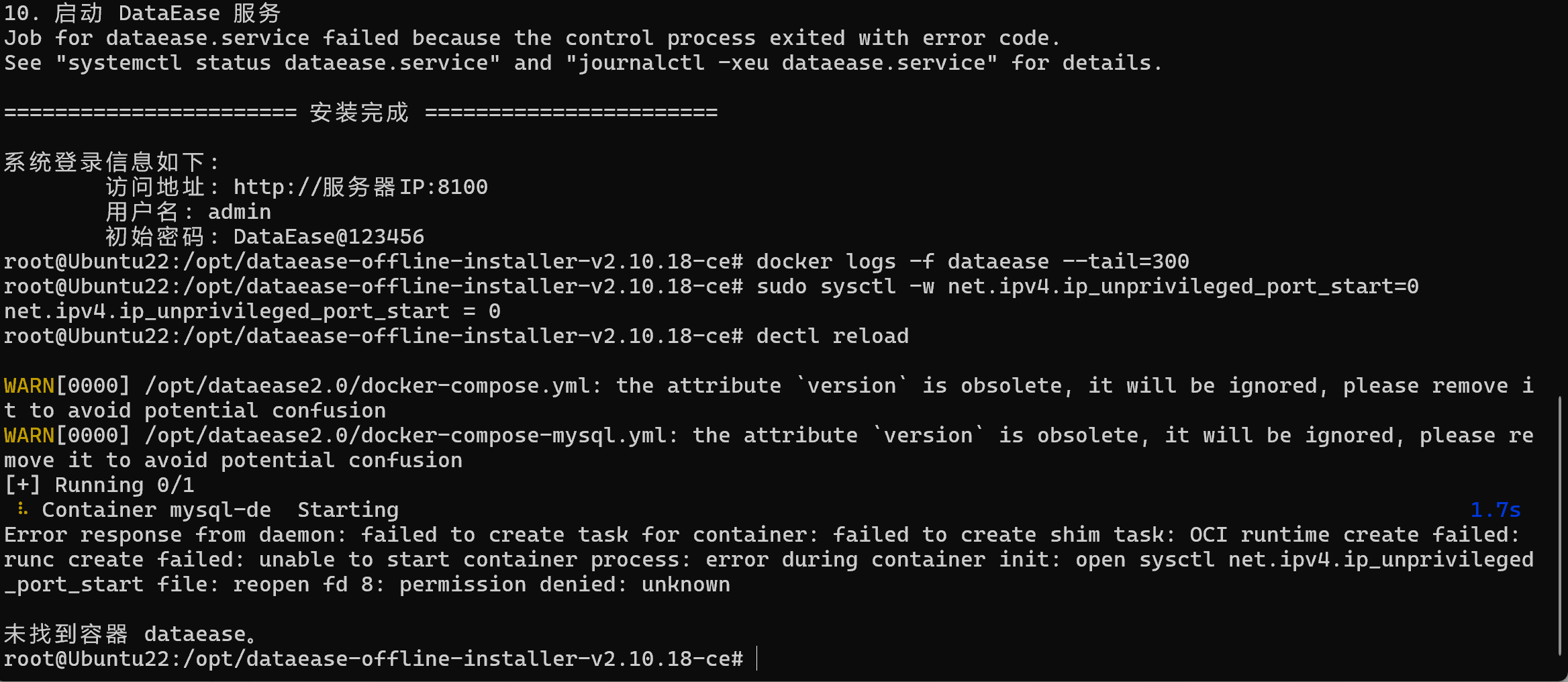

    在Ubuntu 22.04服务器 安装v2.10.18 版本启动的时候报如下错误Job for dataease.service failed because the control process exited with error code.
    See “systemctl status dataease.service” and “journalctl -xeu dataease.service” for details.
    同时容器未启动:
    root@Ubuntu22:~/dataease-offline-installer-v2.10.18-ce# dectl reload
WARN[0000] /opt/dataease2.0/docker-compose.yml: the attribute version is obsolete, it will be ignored, please remove it to avoid potential confusion
WARN[0000] /opt/dataease2.0/docker-compose-mysql.yml: the attribute version is obsolete, it will be ignored, please remove it to avoid potential confusion
WARN[0000] No services to build

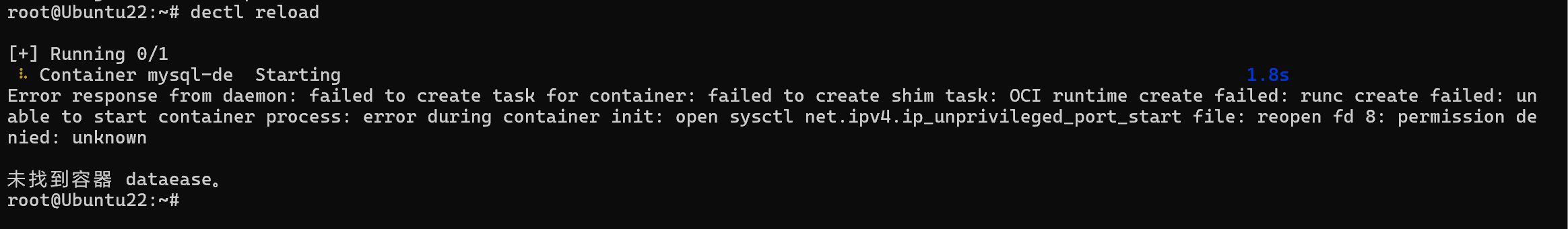

Error response from daemon: failed to create task for container: failed to create shim task: OCI runtime create failed: runc create failed: unable to start container process: error during container init: open sysctl net.ipv4.ip_unprivileged_port_start file: reopen fd 8: permission denied
未找到容器 dataease。

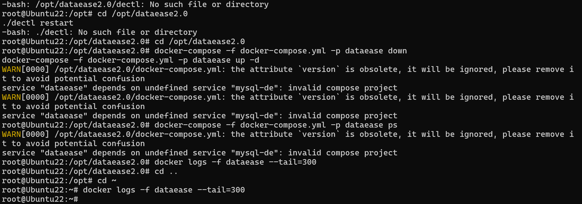

执行下 docker logs -f dataease --tail=300 ,截图看看
没有任何输出
临时修改一下内核参数 sudo sysctl -w net.ipv4.ip_unprivileged_port_start=0然后重启服务试试

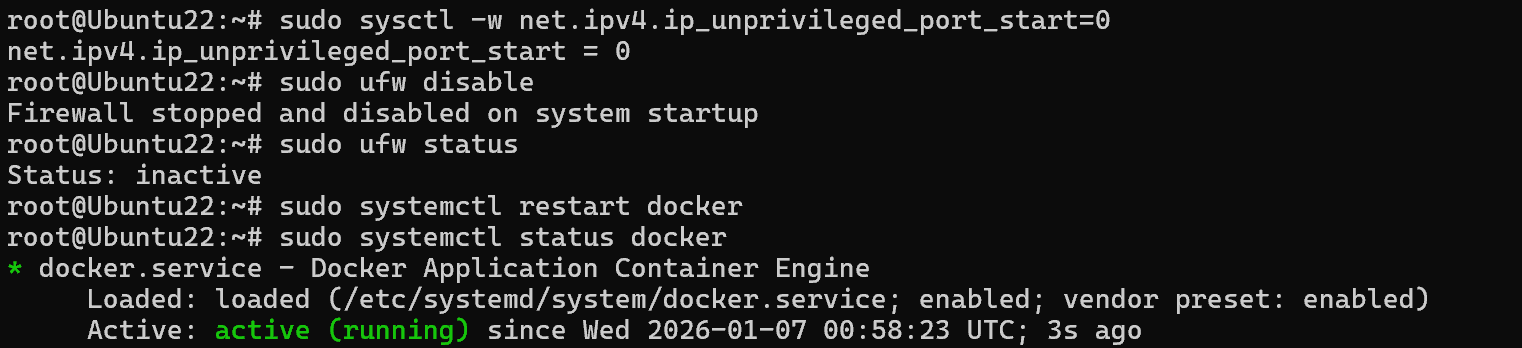

关闭防火墙以及修改内核参数后,重启docker,加载容器
