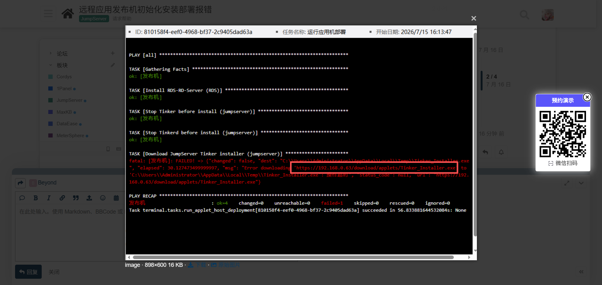

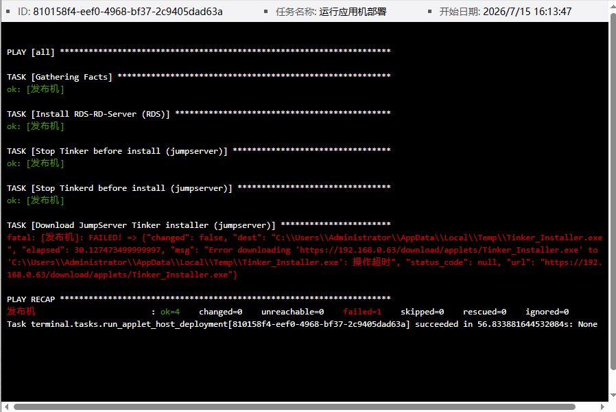

报错信息如下,请帮看下是什么问题
PLAY [all] *********************************************************************
TASK [Gathering Facts] *********************************************************
ok: [发布机]
TASK [Install RDS-RD-Server (RDS)] *********************************************
ok: [发布机]
TASK [Stop Tinker before install (jumpserver)] *********************************
ok: [发布机]
TASK [Stop Tinkerd before install (jumpserver)] ********************************
ok: [发布机]
TASK [Download JumpServer Tinker installer (jumpserver)] ***********************
fatal: [发布机]: FAILED! => {“changed”: false, “dest”: “C:\Users\Administrator\AppData\Local\Temp\Tinker_Installer.exe”, “elapsed”: 30.127473499999997, “msg”: “Error downloading ‘https://192.168.0.63/download/applets/Tinker_Installer.exe’ to’C:\Users\Administrator\AppData\Local\Temp\Tinker_Installer.exe’: 操作超时”, “status_code”: null, “url”: “https://192.168.0.63/download/applets/Tinker_Installer.exe”}
PLAY RECAP *********************************************************************
发布机 : ok=4 changed=0 unreachable=0 failed=1 skipped=0 rescued=0 ignored=0
Task terminal.tasks.run_applet_host_deployment[810158f4-eef0-4968-bf37-2c9405dad63a] succeeded in 56.833881644532084s: None

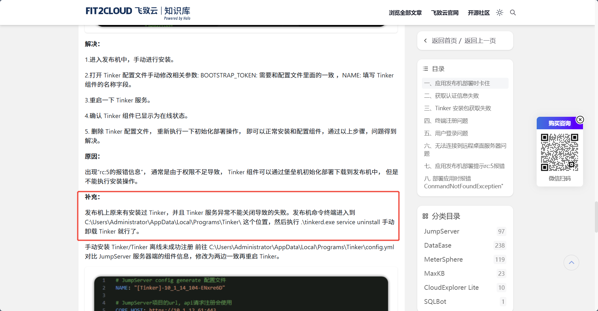

应用发布机问题处理汇总 - FIT2CLOUD 知识库
参考上面的文档卸载后重新初始化部署
卸载了重新部署还是报这个错啊,还有别的办法吗

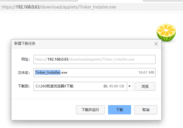

发布机和堡垒机网络互通吗,可以到发布机浏览器上访问对应的tinker下载地址访问试下:
修改了下DNS可以了,谢谢!

通的直接在发布机上访问地址,能弹出下载
