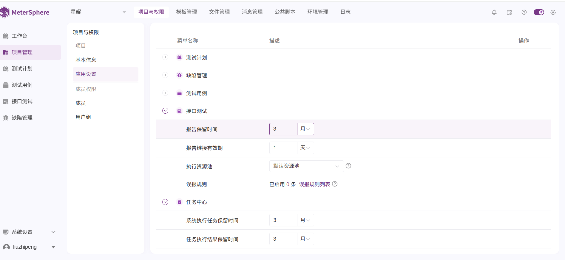

api_scenario_report_detail_blob 这个表的mysql 磁盘占用也太大了,有清理机制的吗
du -sh /u01/metersphere/data/mysql/metersphere/*.ibd | sort -rh | head -15
12G /u01/metersphere/data/mysql/metersphere/api_scenario_report_detail_blob.ibd
217M /u01/metersphere/data/mysql/metersphere/api_scenario_report_step.ibd
193M /u01/metersphere/data/mysql/metersphere/api_scenario_report_log.ibd
108M /u01/metersphere/data/mysql/metersphere/operation_log_blob.ibd
93M /u01/metersphere/data/mysql/metersphere/api_scenario_report_detail.ibd
37M /u01/metersphere/data/mysql/metersphere/exec_task_item.ibd
36M /u01/metersphere/data/mysql/metersphere/api_scenario_report.ibd
20M /u01/metersphere/data/mysql/metersphere/notification.ibd
18M /u01/metersphere/data/mysql/metersphere/test_plan_report_api_scenario.ibd
18M /u01/metersphere/data/mysql/metersphere/api_report_detail.ibd
17M /u01/metersphere/data/mysql/metersphere/operation_log.ibd
15M /u01/metersphere/data/mysql/metersphere/share_info.ibd
13M /u01/metersphere/data/mysql/metersphere/exec_task.ibd
11M /u01/metersphere/data/mysql/metersphere/operation_history.ibd
11M /u01/metersphere/data/mysql/metersphere/api_scenario_step.ibd

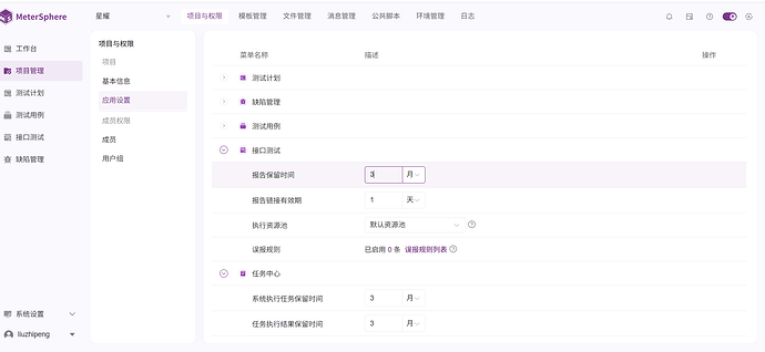

是这里吗?
是的,可以配置定时清理机制
