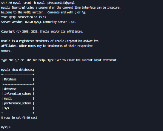

MySQL版本:8.1 (registry.cn-qingdao.aliyuncs.com/dataease/mysql:8.1.0)
一直报错
Caused by: com.mysql.cj.exceptions.CJCommunicationsException: Communications link failure
Caused by: java.net.ConnectException: Connection refused
The last packet sent successfully to the server was 0 milliseconds ago. The driver has not received any packets from the server.

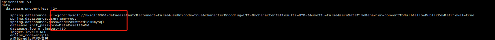

检查了 dataease-config 配置,mysql地址都是对的
