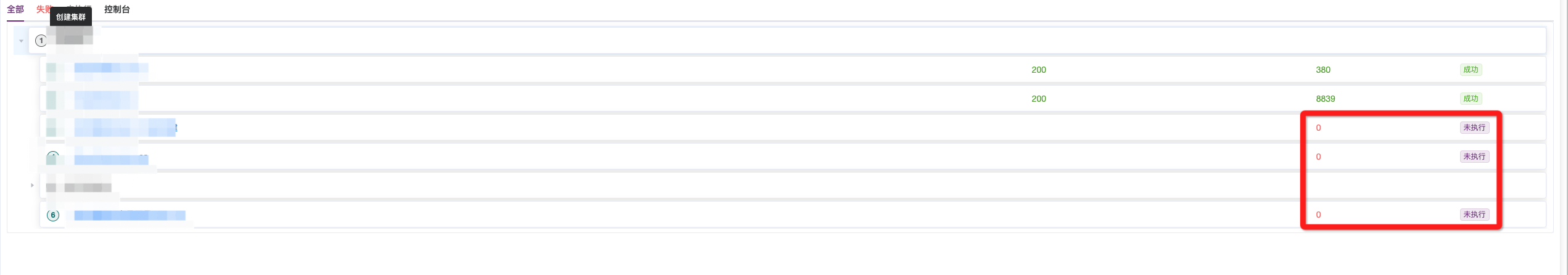

脚本可能涉及到产品敏感信息,不能发出,大概逻辑是轮询几个接口去获取状态是否是预期的,这可能会耗时很长时间

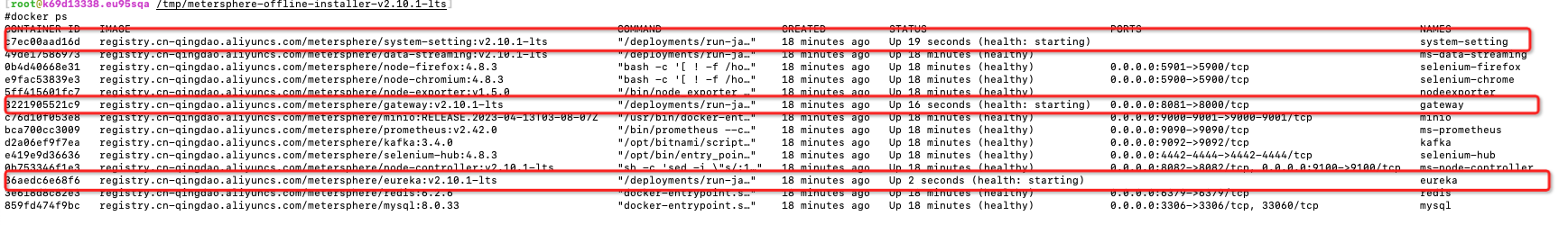

另外我为了解决这个问题,把版本升级到了最新的v2.10.1-lts,但服务起不来,报错redis连不上,这个能帮看看吗?
Error starting ApplicationContext. To display the condition evaluation report re-run your application with ‘debug’ enabled.
2023-06-21 11:24:29,260 ERROR g.springframework.boot.SpringApplication: 823 - Application run failed
org.springframework.beans.factory.BeanCreationException: Error creating bean with name ‘loginController’: Injection of resource dependencies failed
at org.springframework.context.annotation.CommonAnnotationBeanPostProcessor.postProcessProperties(CommonAnnotationBeanPostProcessor.java:303)
at org.springframework.beans.factory.support.AbstractAutowireCapableBeanFactory.populateBean(AbstractAutowireCapableBeanFactory.java:1416)
at org.springframework.beans.factory.support.AbstractAutowireCapableBeanFactory.doCreateBean(AbstractAutowireCapableBeanFactory.java:597)
at org.springframework.beans.factory.support.AbstractAutowireCapableBeanFactory.createBean(AbstractAutowireCapableBeanFactory.java:520)
at org.springframework.beans.factory.support.AbstractBeanFactory.lambda$doGetBean$0(AbstractBeanFactory.java:326)
at org.springframework.beans.factory.support.DefaultSingletonBeanRegistry.getSingleton(DefaultSingletonBeanRegistry.java:234)
at org.springframework.beans.factory.support.AbstractBeanFactory.doGetBean(AbstractBeanFactory.java:324)
at org.springframework.beans.factory.support.AbstractBeanFactory.getBean(AbstractBeanFactory.java:200)
at org.springframework.beans.factory.support.DefaultListableBeanFactory.preInstantiateSingletons(DefaultListableBeanFactory.java:973)
at org.springframework.context.support.AbstractApplicationContext.finishBeanFactoryInitialization(AbstractApplicationContext.java:941)
at org.springframework.context.support.AbstractApplicationContext.refresh(AbstractApplicationContext.java:608)
at org.springframework.boot.web.reactive.context.ReactiveWebServerApplicationContext.refresh(ReactiveWebServerApplicationContext.java:66)
at org.springframework.boot.SpringApplication.refresh(SpringApplication.java:733)
at org.springframework.boot.SpringApplication.refreshContext(SpringApplication.java:435)
at org.springframework.boot.SpringApplication.run(SpringApplication.java:311)
at org.springframework.boot.SpringApplication.run(SpringApplication.java:1305)
at org.springframework.boot.SpringApplication.run(SpringApplication.java:1294)
at io.metersphere.gateway.GatewayApplication.main(GatewayApplication.java:29)
Caused by: org.springframework.beans.factory.UnsatisfiedDependencyException: Error creating bean with name ‘stringRedisTemplate’ defined in class path resource [org/redisson/spring/starter/RedissonAutoConfiguration.class]: Unsatisfied dependency expressed through method ‘stringRedisTemplate’ parameter 0: Error creating bean with name ‘redissonConnectionFactory’ defined in class path resource [org/redisson/spring/starter/RedissonAutoConfiguration.class]: Unsatisfied dependency expressed through method ‘redissonConnectionFactory’ parameter 0: Error creating bean with name ‘redisson’ defined in class path resource [org/redisson/spring/starter/RedissonAutoConfiguration.class]: Failed to instantiate [org.redisson.api.RedissonClient]: Factory method ‘redisson’ threw exception with message: Unable to connect to Redis server: 100.69.100.238/100.69.100.238:6379

Caused by: org.springframework.beans.factory.UnsatisfiedDependencyException: Error creating bean with name ‘redissonConnectionFactory’ defined in class path resource [org/redisson/spring/starter/RedissonAutoConfiguration.class]: Unsatisfied dependency expressed through method ‘redissonConnectionFactory’ parameter 0: Error creating bean with name ‘redisson’ defined in class path resource [org/redisson/spring/starter/RedissonAutoConfiguration.class]: Failed to instantiate [org.redisson.api.RedissonClient]: Factory method ‘redisson’ threw exception with message: Unable to connect to Redis server: 100.69.100.238/100.69.100.238:6379
