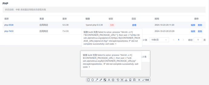

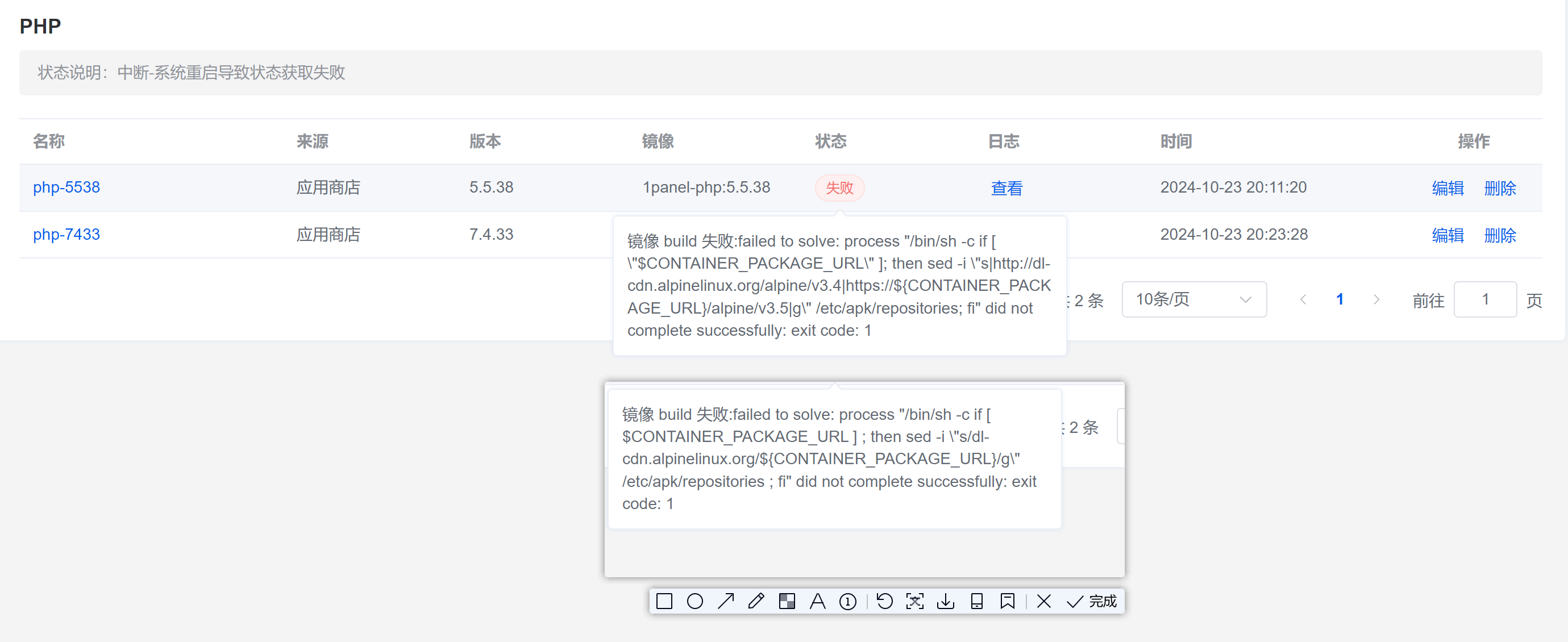

PHP5,7,8无法构建环境
1Panel版本:v1.10.19, php创建运行环境,系统debian11
7.0报错,
:failed to solve: process “/bin/sh -c if [ "$CONTAINER_PACKAGE_URL" ]; then sed -i "s|http://dl-cdn.alpinelinux.org/alpine/v3.4|https://${CONTAINER_PACKAGE_URL}/alpine/v3.5|g\” /etc/apk/repositories; fi" did not complete successfully: exit code: 1
8.0报错
failed to solve: process “/bin/sh -c if [ $CONTAINER_PACKAGE_URL ] ; then sed -i "s/dl-cdn.alpinelinux.org/${CONTAINER_PACKAGE_URL}/g" /etc/apk/repositories ; fi” did not complete successfully: exit code: 1
